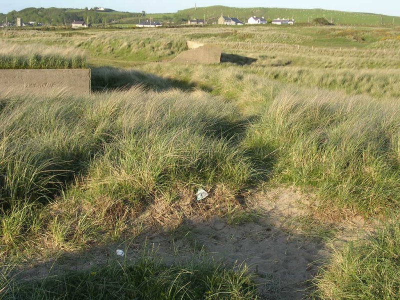

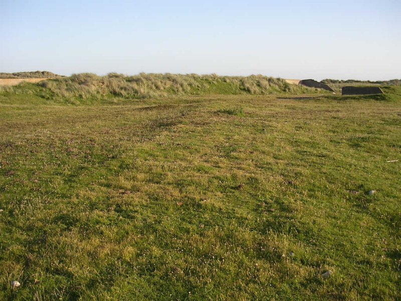

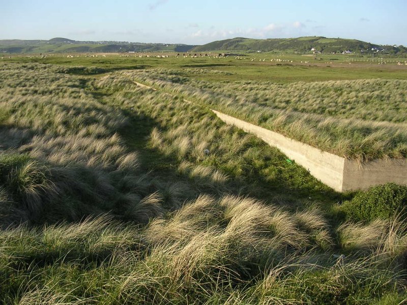

20 Apr 2010 12:54 #164 by Movingtarget
Replied by Movingtarget on topic 200 yard Moving Target Ranges
I still think it's Hell's Mouth....
A view in 2006 looking towards the hangers, note hills in background.
The hangers were near the butressed wall in the top centre of the photos with the sheep in front of it. You can see the wall and hanger bases here
A view towards the additional wall from near W3
This wall was, and still is higher than W2.
Also, looking at the still from the film at 47 seconds, looking out of the repair shelter you can see a white notice board or sign on a post, I think this is on the path to the beach which is just behind the post & wire fence in the photo below, protected by the additional wall.
JohnG
