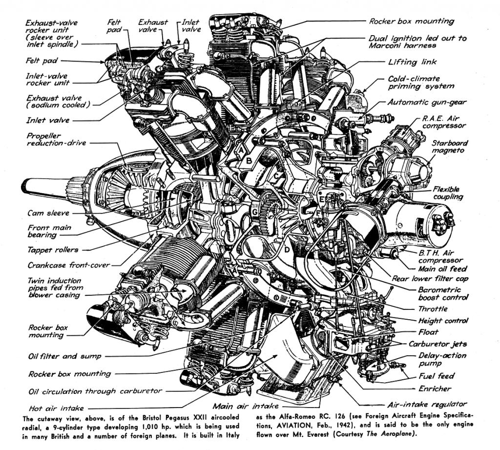

I will stand corrected but the pitch gears would have been covered by the propeller spinner.
Those props are bent the wrong way. The gears you can see are the propeller reduction gears. This cutaway of a Bristol Pegasus shows what I mean.
The propeller is attached to the shaft on the left of the picture.
The only reason I suggested it might have been a stationary undercarriage collapse is in a tail dragger the forces might be directed forwards as the blades touch the ground
Another option is the prop and gears came separately and have been put back together the wrong way around.

Now that makes sense, a prop with a bit of gearbox attached.

Right; I see now that the blades are bent forward. If that cluster is a reduction gear I would expect either the front bevel gear or the rear to be a different diameter to provide the necessary ratio for reduction of the prop speed yet they appear to be the same size like a differential.
