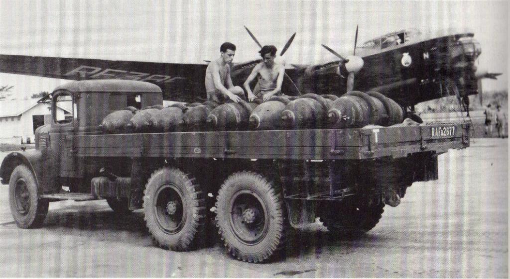

31 Jan 2014 22:03 #14 by ted angus
Would the Bedford QL series have been used for this purpose?
The Austin Tender was a 6x4 3 ton truck fitted with a flat platform fitted with 6 inch high hinged sides and tailboard. The QL wasn't really suitable as the vast majority had fixed sides, Qls mainly equipped the Units that formed 2 TAF, during WW2 few would have been in Bomber Command although towards the end of WW2 the QL Trooper was used for aircrew transport; I will try and attach a picture of an Austin Bomb Tender but Internet Explorer keeps shutting my link down
the attached is post WW2 but gives a good view of the tender
Attached files [IMG]/community/140321=15577-Austin bomb flat 004.jpg[/img]
31 Jan 2014 22:27 #15 by Karl H
Thank you Ted. Now if only somebody made a scale model of that truck. I was wanting to do a diorama of bombs being trammeled off a truck onto the ramp at the bomb dump. Then I got to reading a bit and realized my GMC wouldn't work. I did finally realize that the trucks had to unload off the side and the GMC (to the best of my knowledge) did not have that capability. Now I see the correct truck and my idea shot down in flames : 0 ! But I learned a bit and I thank everyone for their input. I do enjoy the vast storehouse of knowledge here! I guess I could do my 6 x 6 backed up to one without the transvers in front of it.

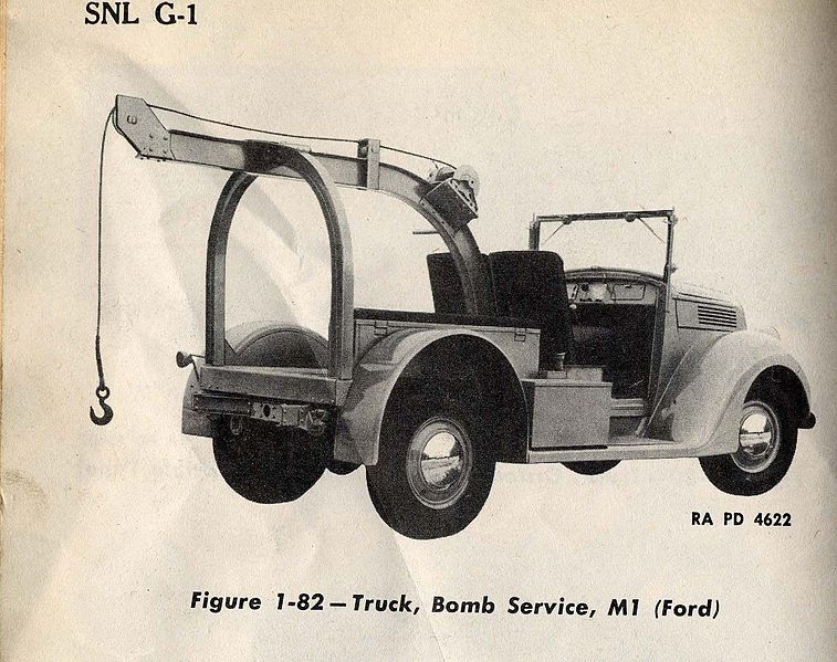

02 Feb 2014 05:26 #18 by Hugh
This is perhaps what you had in mind?
There are several versions by different makers, but they were fairly prolific.

The 3164/42 HE Store was, effectively, imposed on the USAAF since it was the prescribed standard from mid-1942 whether built by US Corps of Engineers or by British Contractors and the workaround by the USAAF when using fixed side trucks was to offload by crane, forktruck or bomb service truck from the trolley road.
