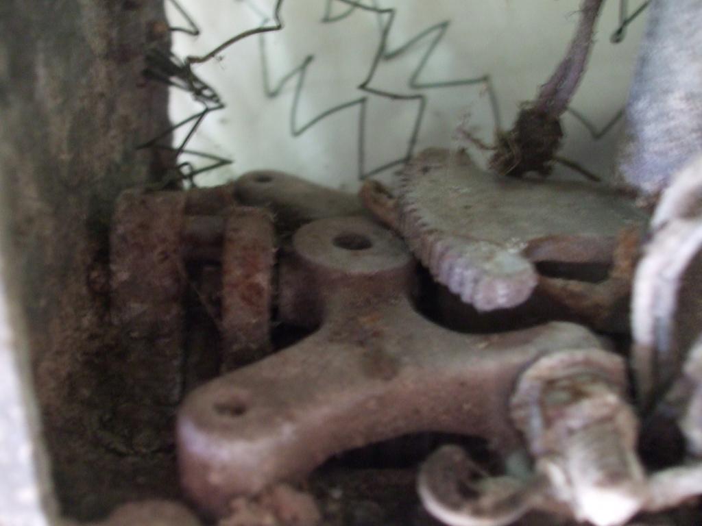

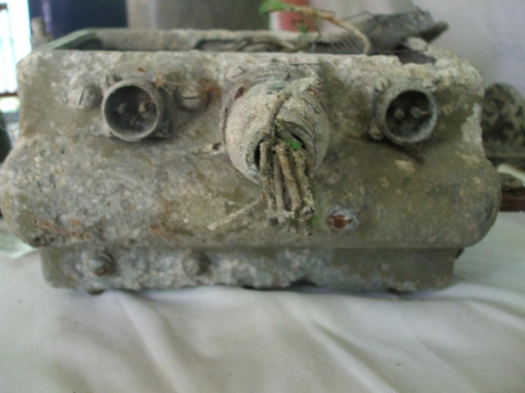

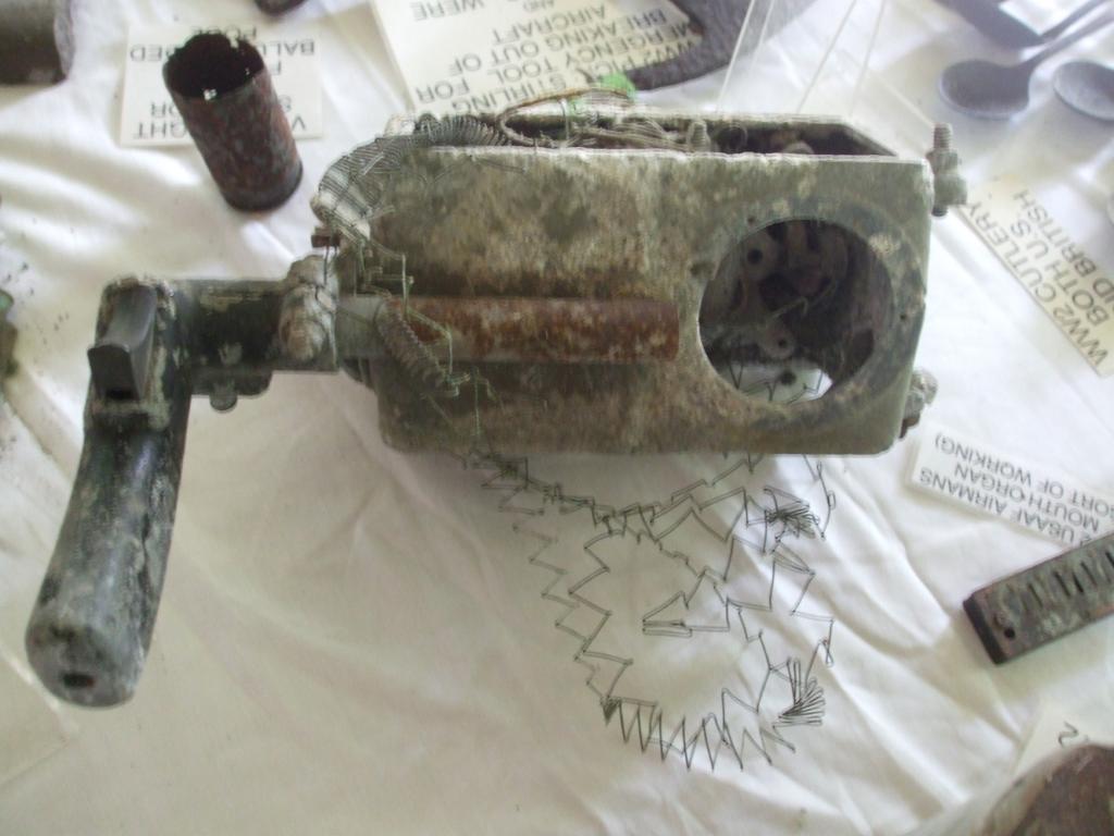

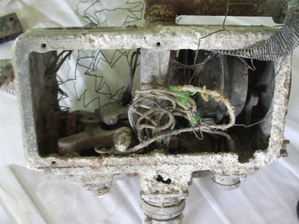

I came across this object at the Little Easton Lodge special open day today (WORLD WAR II DAY & CONCERT). It had been unearthed from somewhere on the Little Easton/Dunmow airfield site, but no one has yet been able to identify what it is.
The trigger on the hand-grip may be a clue, but it doesn't look like the "paddle" grips used to control either the Martin Power Turret (dorsal guns) or the Bell M-6 Mount (tail guns) that were used on the B-26 Marauders based there. Perhaps it's something used on the Stirlings that were there later.
There appears to be a small motor and some gearing within the unit, along with various electrical connectors.
Can any of you knowledgeable folk please identify the mystery object from the following photographs ?

some of the wiring looks similar to a heating element
Long ago and far away

Or part of a rheostat?

that seems more likely with the gear cog and the thumb switch ?operating a rack and pinion sort of thingyou could get a voltage control system similar to a scalelextix hand set perhaps for controling an electric motor such as one used to swivel a turret perhaps.

As Peter said, the zig-zag wire would have been wound around a circular former, probably ceramic since it would need to be insulated. The former has disintegrated leaving the nichrome wire unwound. A spring-loaded contact would have 'wiped' around the wire varying the circuit resistance for a control function.
Having a natural interest in gun turrets I have some knowledge and reference sources on the subject but cannot yet match the control to a gun installation. Turrets usually had a single stick control or 'handlebar' controls with twin grips so it may not be related to armament.

The trigger would imply some element of control over the amount of power. Would some sort of instrument require a trigger control?
