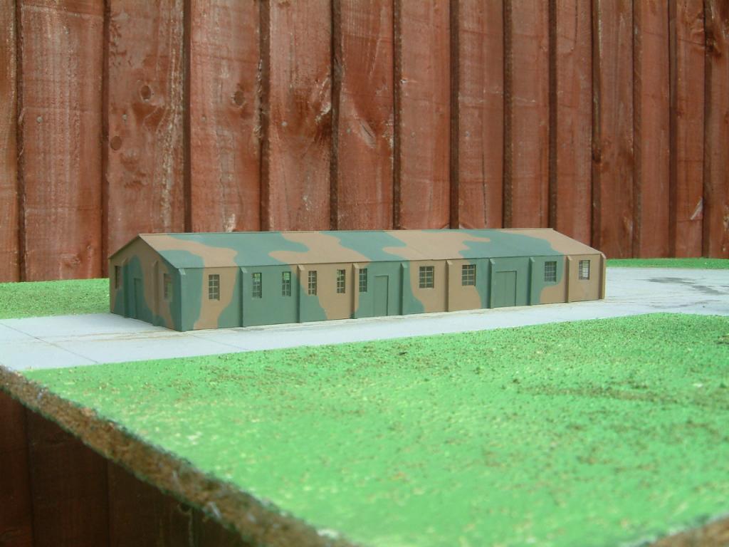

Recently finnished the Armoury building for my diorama, (one less to build ..:grin:) Ian

You got your priorities right Able!:wink:

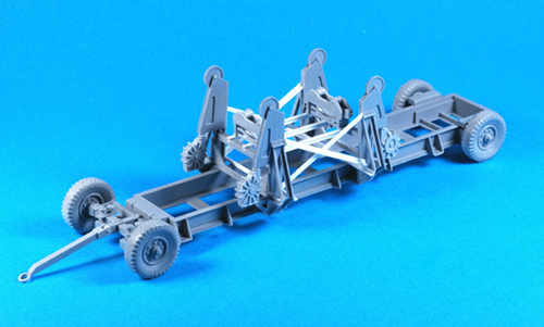

GENTS I am building a type H modified bomb trolley I am after a 1/72 Grandslam or Tallboy to finish it can anyone help me please

You mean you want an actual scale model bomb?

Hi Peter yes I am doing a series of bomb trolleys and an Austin K6 bomb Flat. I have 4 decent 250 pounders which will go onto a couple of type Fs and a 4,000 lb Cookie that goes with a Type D. But I have a great little kit of a Type H with all the raising gear for Tallboy or Grandslam. I could make it as a basic type H and put an 8000 or 12000 pounder on but it seems such a waste as its a lovely kit. Both the Grandslam and Tallboy are contained in a couple of Lancaster kits but I cannot justify the expense for a bomb, I would never make the plane and my sons and grandson are into fast jets and helicopters.
